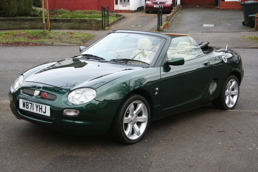

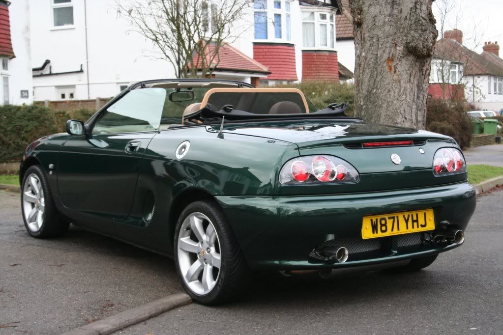

Results of a Claying Session!!
Very Pleased with the result!!!
