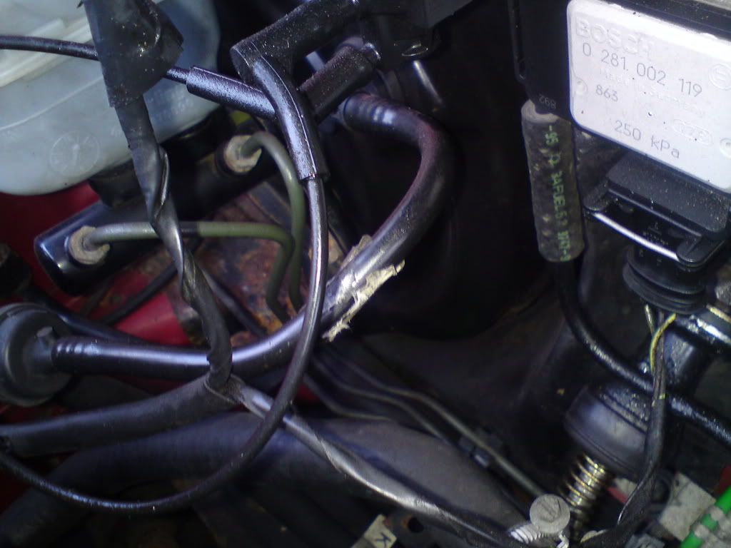

post #76 of 109 (permalink) Old 21-03-2011, 17:10
Join Date: Jan 2011
Location: Castle Bromwich
Car: Rover 75 135 cdti
Posts: 1,202
sorry to drag up an old thread but i just want to be sure im doing this right before i start hacking into pipes.
it looks like daves map sensor is in a different locale to the one on my 220sdi. can anyone confirm from the pics below if the pipe with the ripped sticker on is the pipe to cut into and place the t-piece into. many thanks, si.

post #77 of 109 (permalink) Old 21-03-2011, 17:16
Diesel Tuning Dude
Dakta's Avatar
Join Date: Jul 2007
Location: Wakefield
Car: 75 Tourer Conn SE & 45 TDi VNT
Posts: 17,817
Send a message via MSN to Dakta
No, that's your vacuum supply
The pipe with the green writing on the right hand side is the one you want
Dieselpowered - file revisions ahead of the competition
Dakta is offline
post #78 of 109 (permalink) Old 21-03-2011, 17:18
Join Date: Jan 2011
Posts: 1,202
and this ladies and gentleman is why you geta second opinion before brandishing a junior hacksaw to various pipes in ones engine bay!
as always the mad scientist comes up trumps. many thanks dakta. and the bright green pipe thingy below is where i feed the air pipe through the bulkhead?

post #79 of 109 (permalink) Old 21-03-2011, 17:33
Diesel Tuning Dude
Dakta's Avatar
Join Date: Jul 2007
Location: Wakefield
Posts: 17,817
I think that's the most convenient location on the 200's/25's/zr's...that's where I went through for my 200SD, someone might know of a more convenient place though!
I too am glad you didn't cut your brakes vacuum supply, might have made an interesting trip
