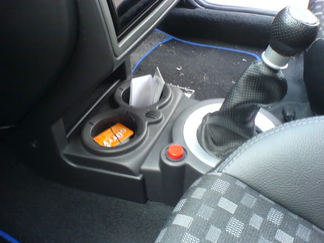

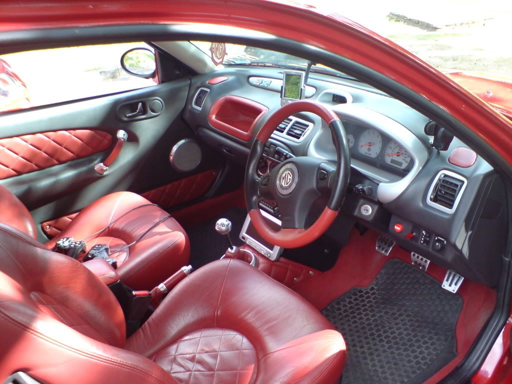

Here's a few pictures to give you ideas on where to mount the button:
My Mk1 ZR - I drilled a hole next to the ignition barrel and fitted it there (well, Si actually did this one for me! )
*EDIT* I now have mine where the cigarette lighter was:
Hollie's Mk1 ZR - I fitted this in one of the spare panels that just prise off... handy if you don't want to drill a hole in the car:

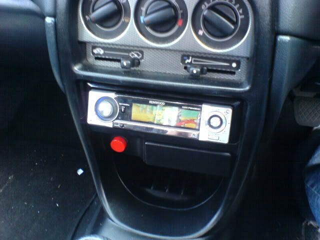

Ross' Mk2 ZR - I routed extra cable along to the gap left after we had removed his cigarette lighter... the larger button sizes fit PERFECTLY!

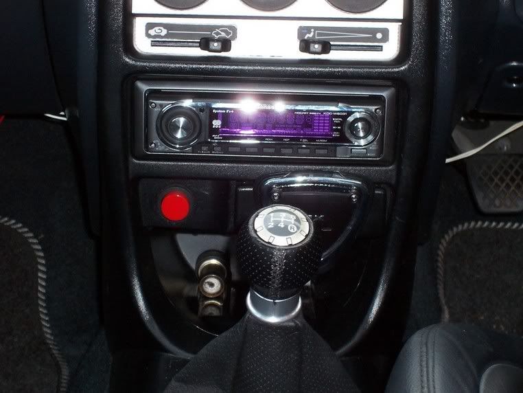

YoungY's Mk1 ZR - Again we removed his cigarette lighter and fitted the button to the resulting gap... my personal favourite mounting point
SuZy's Mk1 ZR - Same positioning as YoungY's:
