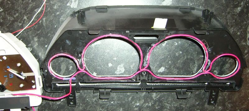

I changed to dials on mine to stainless steel with 3 colours for the display. The odometer was stripped and I made my own diffuser and LED hard wired in. The light aound the sides of the dials is done wih EL wire
I replaced all the switchgear with alloy switches that light up blue (except the hazard switch)
The heater surround was also made in stainless steel to match the dials with the same colours.

Some of the mods I have done have been incredibly easy (and cheap) others have been downright expensive and right roayl pain and I never want to attempt them again.
Just as a quick, easy and cheap lighting mod that can be done to your dials is the addition of some EL wire inside the reveal. You can get this in lots of different colours and the effect can be pretty good especially on the ZR dials with the silver faces.
This was mine that I did with purple EL wire
and this was a friends that I did in Aqua
All you need to do is strip the dials and stick the EL wire of your colour choice to the inside of the reveal
