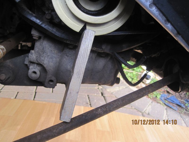

Removed OFFside front Road Wheel and placed car on Axle Stand. Located the Stand on one of the reinforced rails under the car. That allowed me to use my 22mm Socket and Breaker Bar to correctly align the engine into the "SAFE" position.
Then using my DeWalt 240volt Mains Impact Wrench I released the CRANKshaft Pulley Bolt. I thought it was not going to cope with the job as the Wrench struggled for several seconds then the bolt suddenly loosened :~
Then replaced the 22mm Bolt back in its location and realigned the engine into the safe position. The Impact Wrench had moved the CRANKshaft a few degrees away from safe :~

Got stuck in again today and only managed two pictures. First one shows a useful "Third Hand" technique ( well piece of wood ) I use to hold the Polyvee Drive belt in place when aligning it over the CRANKshaft, AirCon Compressor, Alternator and Tensioner Pulleys. With patience there are many two man jobs which can be completed single handed if you think about how to go about things.
