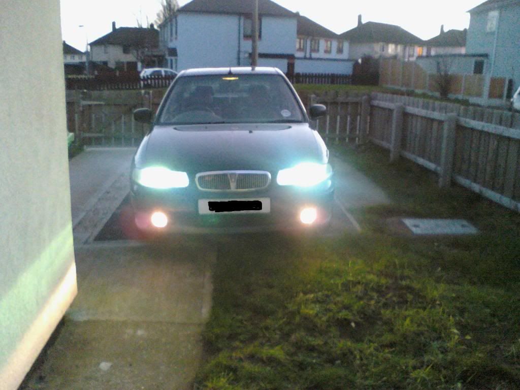

i got the 6k ones and heres a pic of them with the blue coated zenons in the lowers

No problem with my night breaker bulbs, this pic is in the day so a lot brighter by night. Be careful if you go down hid road as you can have mot problems with some testers, due to beam pattern, electric headlamp adjusters and headlamp washers if not fitted.
adjusters and washers not required , beam pattern problems are down to having the incorrect bulbs fitted , ie h7 hid instead of h7R hid

Depends on what tester you go to, your car would not pass it's mot at my local station. Your beam pattern looks scattered in your picture and my tester insists car not fitted with hid lights from factory need to have head lamp washers and electric adjusted lamps but like I said it's a lottery on which tester you go to.
beam pattern is spot on and better than the original bulbs , they can not fail on no levelers and no washers if they are not fitted . only factory fitted ones will fail on them if they arnt working .
i would also direct your mot tester to the vosa mot page regarding retro fitted hid lights and get him to re-read the page as he either just doesnt like them or he has incorrectly read the page.
if he is failing them ( after market hids ) on no levelers and no washer he isnt doing his job correctly and incorrectly failing cars .

Originally Posted by Andy400 View Post
.......beam pattern problems are down to having the incorrect bulbs fitted....
Beam pattern problems with aftermarket fit HIDs are normally due to fitting HID lights into headlamp units that are not suitable for them - standard headlamp lenses for tungsten or halogen bulbs will not focus the light from HIDs correctly (no matter how you try and adjust them). The result is always a lot of light 'bleed' in all sorts of directions.
It is pretty obvious from your photo that your HIDs are bleeding light to a horrendous degree. If your MOT tester is telling you that the beam pattern is OK, he clearly isn't checking it correctly (or possibly at all!). I bet oncoming drivers issue a string of expletives when they meet you coming the other way at night
Frankly, it is my very strongly held opinion that people who fit HIDs to unsuitable lamp units should be shot on sight. If you can't see adequately to drive safely at night with standard fit 55 watt halogens, it is your eyesight/night vision which is at fault, and blinding oncoming drivers is not helping road safety and is not the answer.

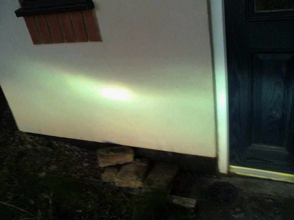

the reason why they look like they do is because i was kneeling down and trying to get just above the line of the light beam , and yes people are fitting incorrect bulbs blinding oncoming drivers which is why i said in the original post to make sure he gets the bulbs with R on the end which are designed to stop the oncoming blinding and proved correct beam patterns with reflector type head lights hence the R = reflector , they have a specially design black out strips to stop this and fix the problems caused by fitting the normal h7 hid bulbs.
here is the pic of the beam taken with dirty headlight lens it is now much tighter beam as i cleaned the lens but this was taken when i first fitted the kit.
