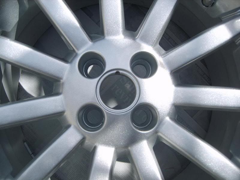

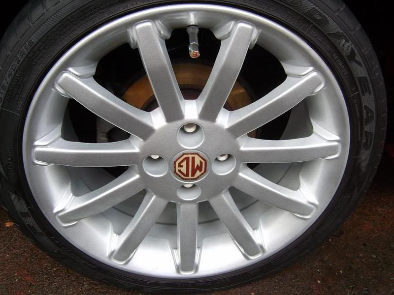

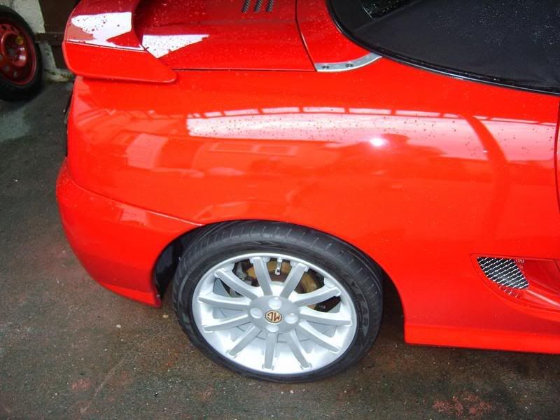

well as i couldn't make the service day i thought i'd make use of the time i had yesterday and today and refurb my alloys
Managed to get hold of the Sparkle Silver spray paint for a perfect match and put them back to showroom condition

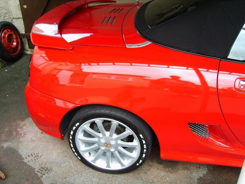

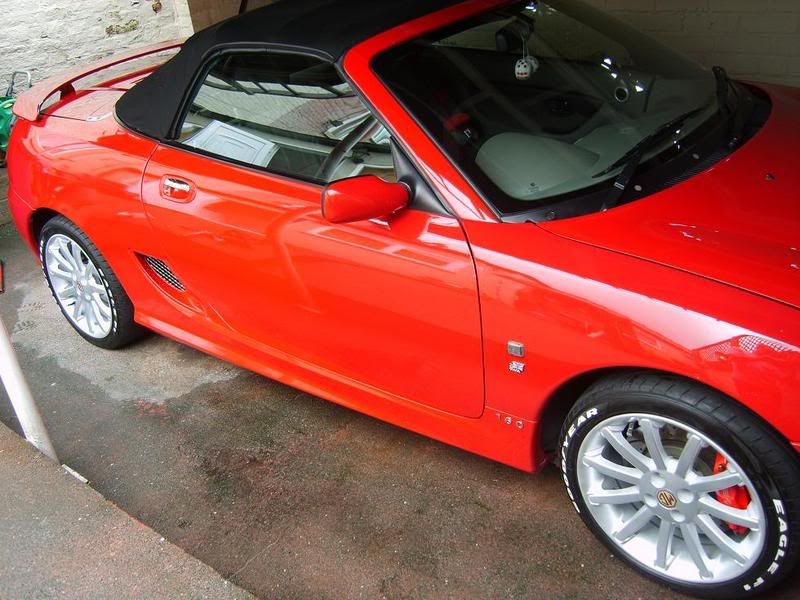

the wheels were pretty badly scuffed round the edges and needed doing badly, then decided to go for the tyre lettering painting too in the end which isn't everyones taste i know but i think it looks great
Gotta say, i'm more than chuffed with the results
anyway here's the pics

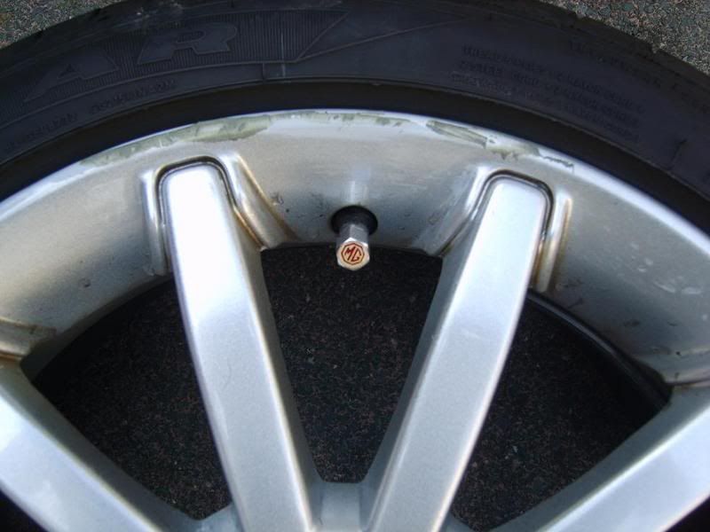

started off rubbing them down to clean them up and see the real damage then filled the scuffs with metal filler (should be ok as they are only scuffs)
then primed with white primer
the rubbed down again with finer wet and dry then put on Sparkle Silver
Finished off by applying Laquer
The finished result
Then as mentioned earlier, decided to go for the Tire Lettering to finsih them off, i used a tire paint pen from Halfords and applied 4 coats on the letters, didn't actually take that long with the wheels off

Originally Posted by Catweazle View Post
Really good job!
Where did you get the metal filler for the scuffs? as I need to do a similar thing.
Halfrauds it's just "Chemical Metal" but just like body filler tbh but i gotta admit it goes pretty rock hard compared to normal filler and sets rapid

Cheers all they do actually look brand new tbh but with more paint on them than originally i'm more than chuffed how they've turned out
yeah they look cool i think with the lettering
I could have had them all done on 1 day but i've had her dad's 60th in the way so today and yesterday
I got the sparkle silver from autocol in Bury, i did post on here somewhere the address and website but can't remember where i posted it, they have a place in bury and 1 in birmingham and a website. I can re-post address if anyone needs it

I actually did a test on the rear of the tyres about 2 months ago on 2 letters and they have cracked a little and faded but it would only need a couple of coats to put them right so i guess for ultimate would be once a month or once every 2 months will probably be ok.....takes about 3 hours from scratch so i guess 1 -2 hours to top up on them once every couple of months.....i'll let you know

to do my wheels complete it took about a day and half with breaks and cost me around 60 for all 4 but mine are Sparkle Silver which is pretty easy tbh
