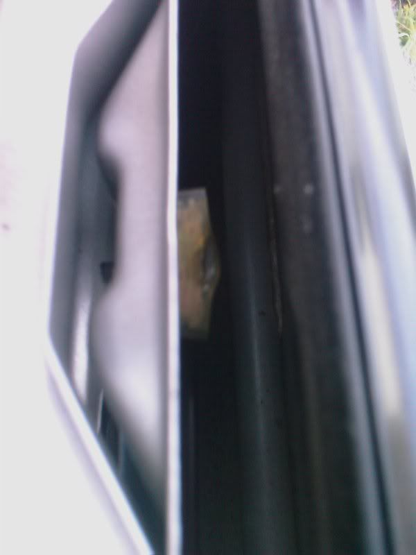

Hello all.
I was parking my car today, put the softtop up, Opened both doors to wind up the windows (I found it to be more watertight when I do this) and bam, window stop broke. I was far from home and the window would not come back down, it was stuck up. The problem is that I was unable to close the door now.
Lucky me, had some basic tools in the boot. I really needed to close the door.
This is what I used, could come in handy for other owners, it does not take up to much space. A screwdriver and a 10mm bit.
Take off the doorcard, check out CJJs excellent guide if you don't know how to do this.
I had to unscrew the two 10mm bolts that hold the glass inplace:
"Front"
"Rear"

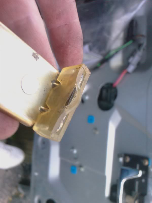

The window was stuck on part of the window stop mech seen in this pic.:
I unscrewed the two 10mm nuts that keeps the window in place, then I unscrewed the window part mech, location:
A picture of the part I unscrewed:
After doing this was it possible to lower the window and reattach the 2 10mm bolts. I needed to undo them do "wiggle" the window a bit.

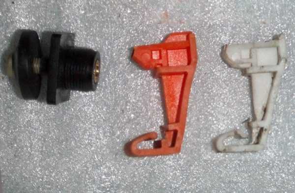

Over to a question; Is it possible to buy this part of the window stop? I have the one on the far left, the black one. (Picture is borrowed from Dieters page)
Do I need to buy the black bit and the bit I have disassembled from the car? Any suggestions to where? Thanks guys.

Hi Morten, nice one
You should only take the left one as they replaced the old plastic ones (middle and right on the pic).

It seem to me that only the orange/yellow part is damaged, is there anywhere I could buy this part? Is it a set?

Turned out to be an easy fix. Just turn the yellow rubber thing and turn the window stop 180 degrees. Had to take out the window, have to wait until it rains to see if she still is watertight.
Pictures says it all:

Oh well Sir, nice fix
I got it all wrong and thought you wanted to buy all above shown windows stoppers as one set. Good that I didn't reply so far
You need CUN100390 (set of two), to be sure check above EPC-link (no. 5)

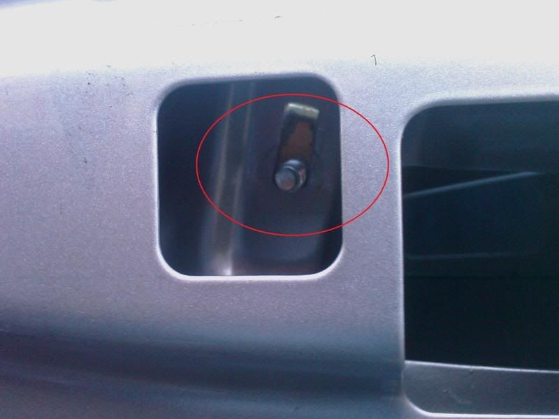

The problem I was trying to solve was the window riding way too high..it was actually riding over the door stop.
Think I got there in the end...as per MGFNorways notes, remove the door card, and the door speaker.
The offending piece is located as per the first pic, the hole I'm pointing at.
Once you have unscrewed the door stop, it will probably fall down inside the door, which is one of the reasons to remove the speaker.
The second pic shows the stop from the door, and you can probably just make out the damaged plastic which my window stop was riding up and over.
There were two washers already on the stop (not sure if this is normal), so I added one washer, and pulled off the yellow plastic cover, then replaced it after turning it through 180, exactly as MGF Norway says...The third pic shows the three washers, held in place with some tape so they dont fall off when you do the next fiddly bit.
The easiest way to get it back was as the fourth pic shows...hold the stop in my left hand and reach up through the speaker hole. You have to wiggle it past the glass, and I found the easiest way to direct it into the hole was to guide it from above using a screwdriver (having nearly gotten my fingers stuck earlier).
Then screw it lightly back in place.
put the window up to the desired point, then tighten it.
My window now stops instead of riding up way too high, its in a line with the front edge of the cheater.
The window doesn't run up quite as smooth as it did, the back jerks up a little before the front moves, and it seems a touch clanky, so I guess I have to adjust a few other things to get it perfect. At the top of its travel it moves in (in towards the car) quite a bit, not sure what causes that.
