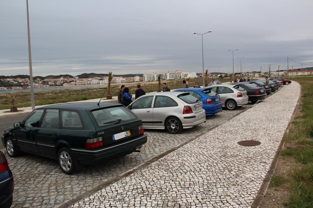

This time, I was to organize this year's MG-Rover Club Portugal National Meeting, which was in my hometown (Caldas da Rainha), as it was the first time I did something like this.
So, I was able to get all my Rovers to the meeting (both 213s, the Tourer and my brother's 200 Diesel).
The Jacinto bothers' Rovers, together.
This one, unfortunately, isn't part of the family. But I wanted to share it with you!
