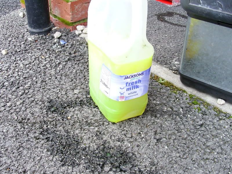

Jack
10mm socket and spanner, 17mm spanner
An empty 2L milk bottle
Someone to repump your hydragas when it's all over (independent hydragas operators from The Hydragas Register are much cheaper than garages and they will often travel to you – useful as you won't have any suspension with which to drive to them).

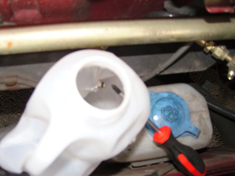

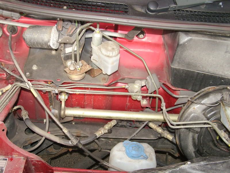

Next, you need to depressurise your hydragas system. The valves can be found under the bonnet, and are just like bicycle tyre valves. You simply jab a screwdriver inside and the fluid comes out. It is pressurised to almost 400psi though, so you'd be wise to contrive some sort of protection against the escaping fluid. I chose to make two holes at the top of an empty milk bottle, and stick my screwdriver through to depressurise. Each side seemed to release just over 500ml.

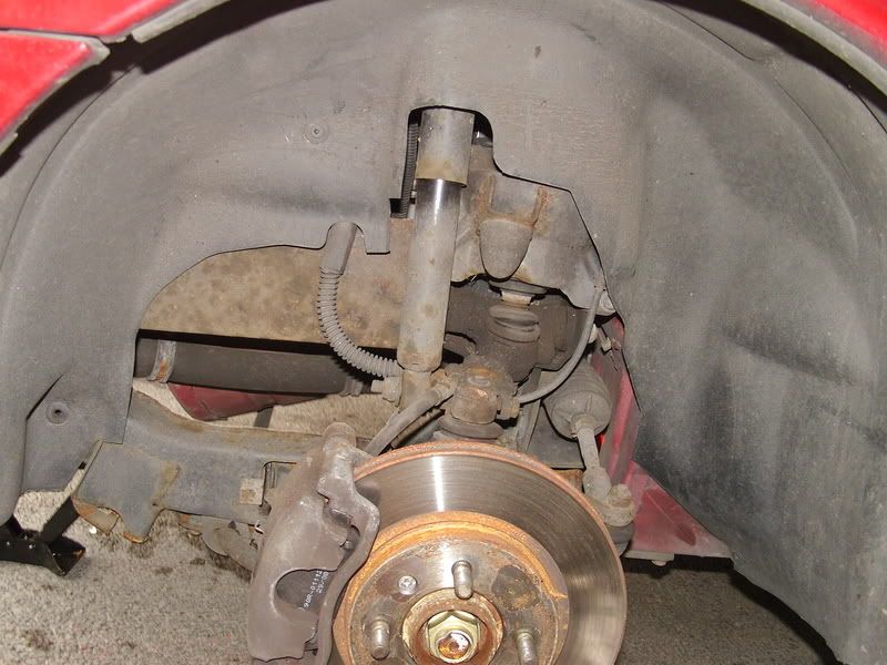

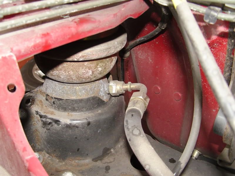

To access the front hydragas units you need to first remove the plastic cowl above the road wheel. These are held in by rubbish plastic screws around the edge mostly. Undo screws and yank out.
Next you will see the brackets holding the hydragas units in place, held in by four 10mm bolts. The two at the bottom attach to the body of the bracket, whereas the two at the top have a nut behind them which you'll need to hold in order to remove the bolt. You also need to remove the cable attached to the bracket, this is done by simply unclipping it from the metal hook.

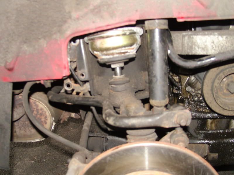

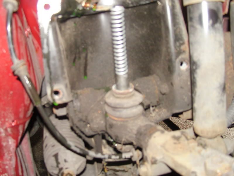

Now you will see the hydragas unit itself. The only thing holding it in place now is the hydragas valve. You get to this from under the bonnet, and will need a 17mm spanner to undo them.
After that, you just need to lift the unit off of the knuckle and pull it down under the wheel arch. This is a bit tricky, but don't be afraid of using a little force.

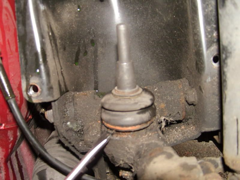

This exposes the lowering knuckle:
If you are installing the lowering pins this is where you remove the knuckles. Simply insert a flat screwdriver beneath the orange plastic rim and ease it upwards. Be careful here as the plastic is brittle.

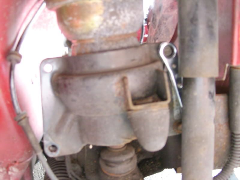

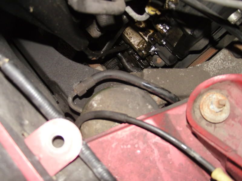

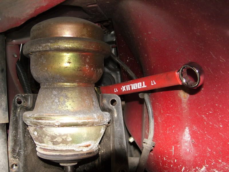

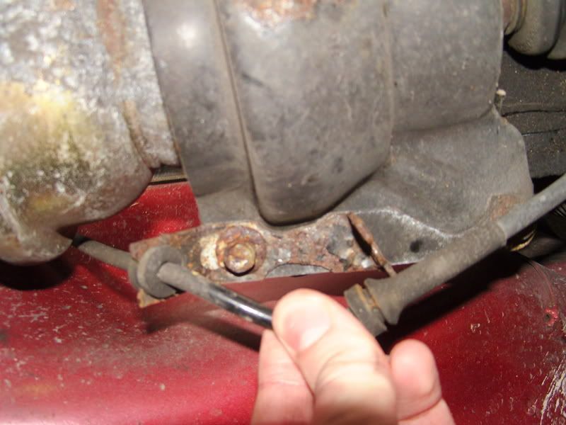

For the rear hydragas units, things are a little more complicated, as access above them is much more restricted. They are again held in by four bolts, but to remove these I had to disconnect the shock absorbers at the bottom (you'll need 13mm and 17mm spanners as I recall), and move the coolant tank out of the way so my arm would fit in (this is held in by two 8mm bolts).
This shows the top of the hydragas unit, just below the two cables.

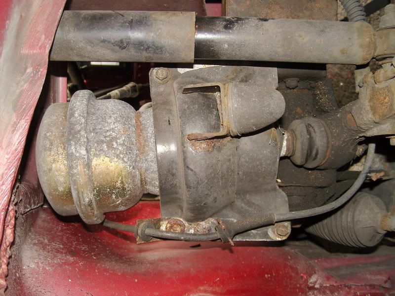

View of the exposed rear unit. You'll have to use some force to persuade it out.

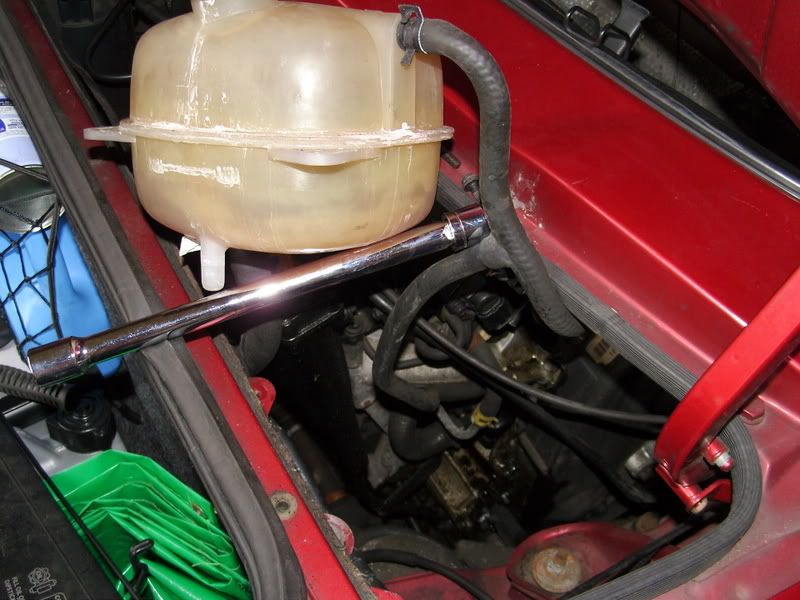

I struggled to fit my 17mm spanner into the engine bay and turn it at the same time because it was so long, so I used a small adjustable spanner instead. Apart from that the rears are removed in the same way as the front pair.

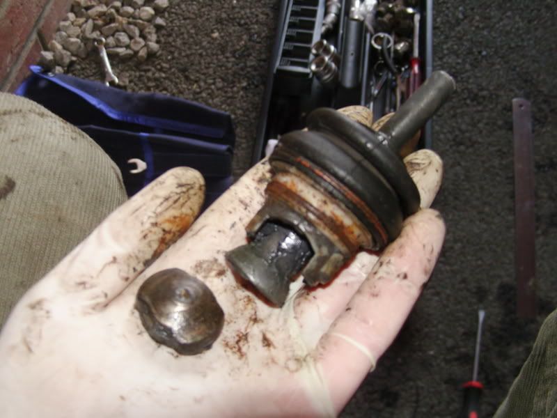

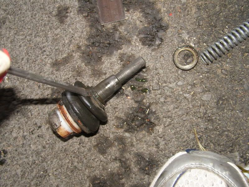

First, remove the spring and washer that sit on top. Then use a screwdriver to prise off the circlip holding the rubber over the shoulder of the pin.

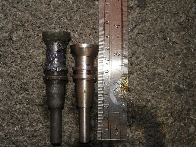

To remove the pin, hold the knuckle in the middle and tap the thin end of the pin onto the floor – this should push it out the other side. Insert new pin.
I was somewhat dismayed to see that the MS pins are in fact only 10mm or so shorter than the old ones – not sure how this can translate into a 30mm reduction in ride height as advertised!
When you're reassembling, the only tricky bit is getting the circlip back on. I found it easiest to get it over the rubber lip first, then prise them both together down over the shoulder of the pin.
After that, reassembling is very much the reverse of what you've just done. Be sure to tighten the hydragas valves properly – you don't want to take everything apart again to fix a leak. Remember that when you pump up the hydragas afterwards you're looking for 369mm (+/- 10mm) ride height, measured from the centre of the wheel to the wheel arch above, or 339mm (+/- 10mm) if you've installed lowering pins.
The reason for this is because of the leverage ratio that the hydragas unit operates - which is 3:1. I.e. 10mm at the length of lever (the top arm) at the hydragas unit translates to 30mm at the end of the top arm.
