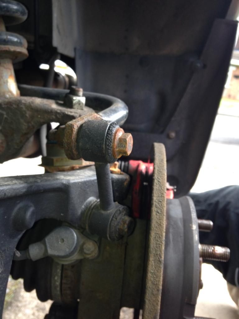

Step 4) Remove the upper bolt from the drop link.

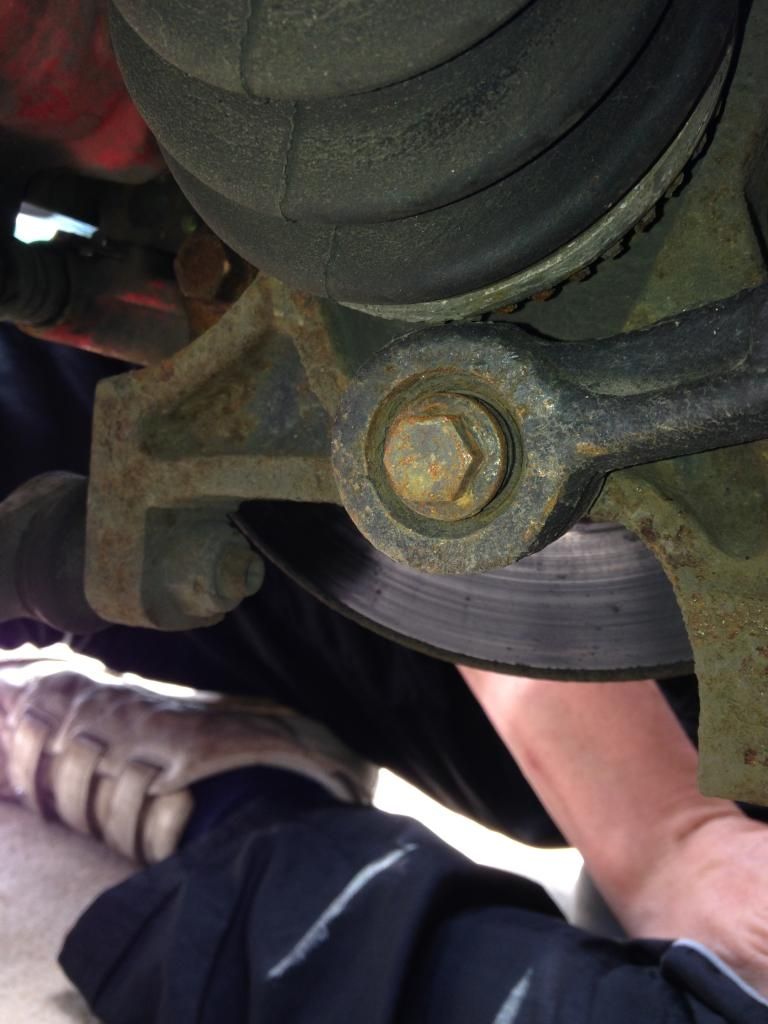

Step 5) Remove the trailing arm. Start with the 2 bolts at the hub end, they should come out easy.
1 at the top

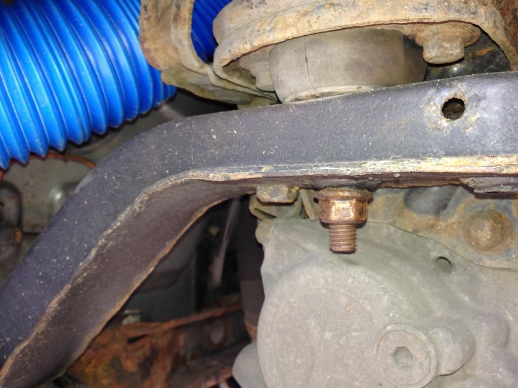

And 1 at the bottom

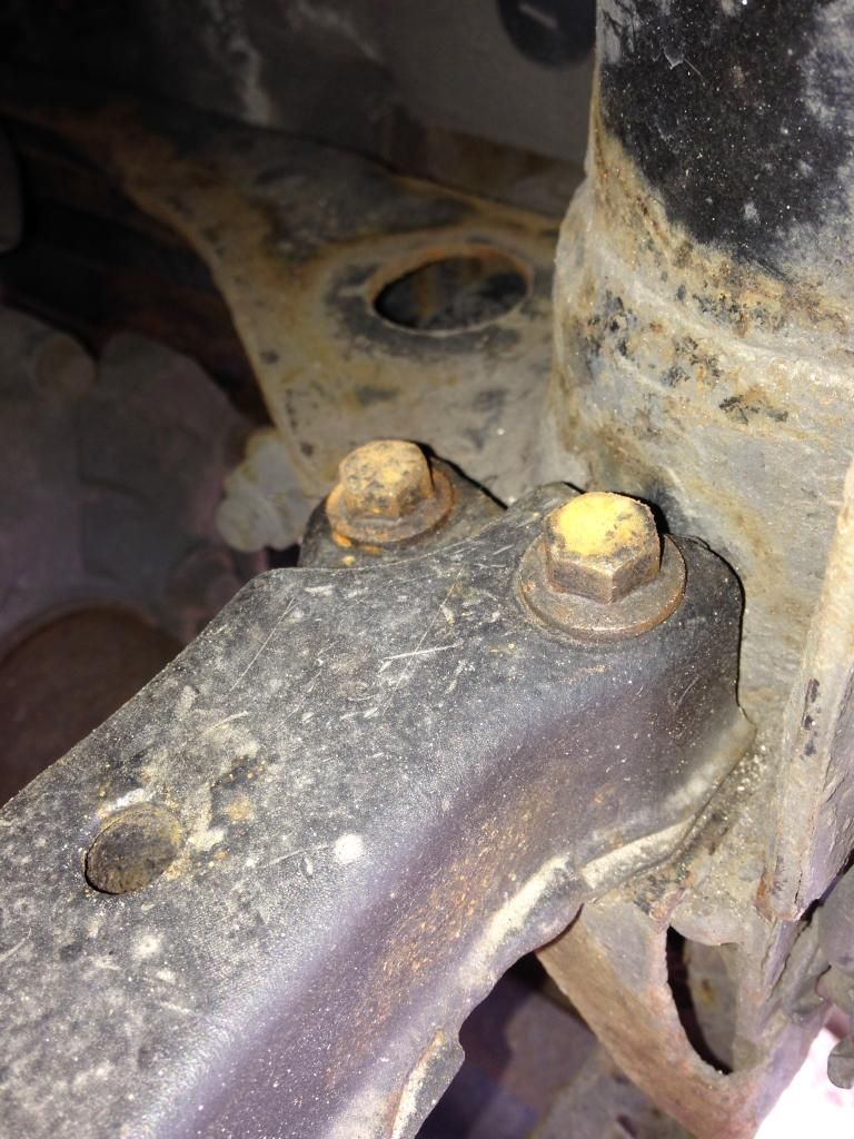

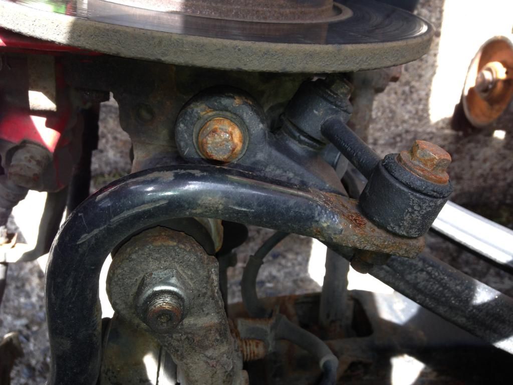

Then remove the large bolt going through the bush. This is where I had my first issue. The nut came off easy, but the bolt was stuck in the rubber bush. I had to use a socket extension bar and with my trolley jack, I forced the bolt out from underneath. Yours may come out easy...
From above
From below

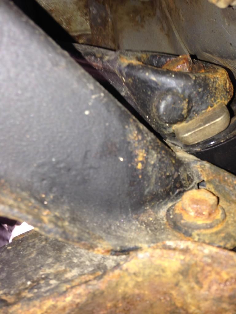

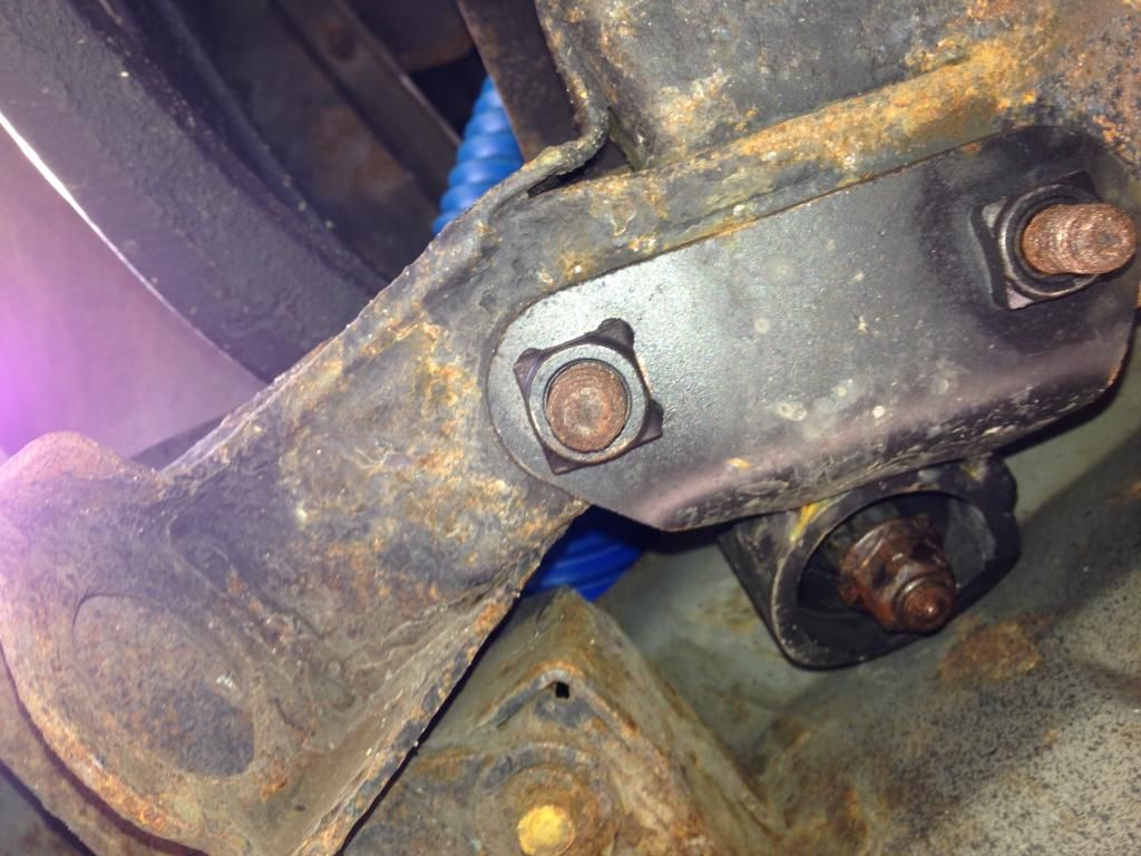

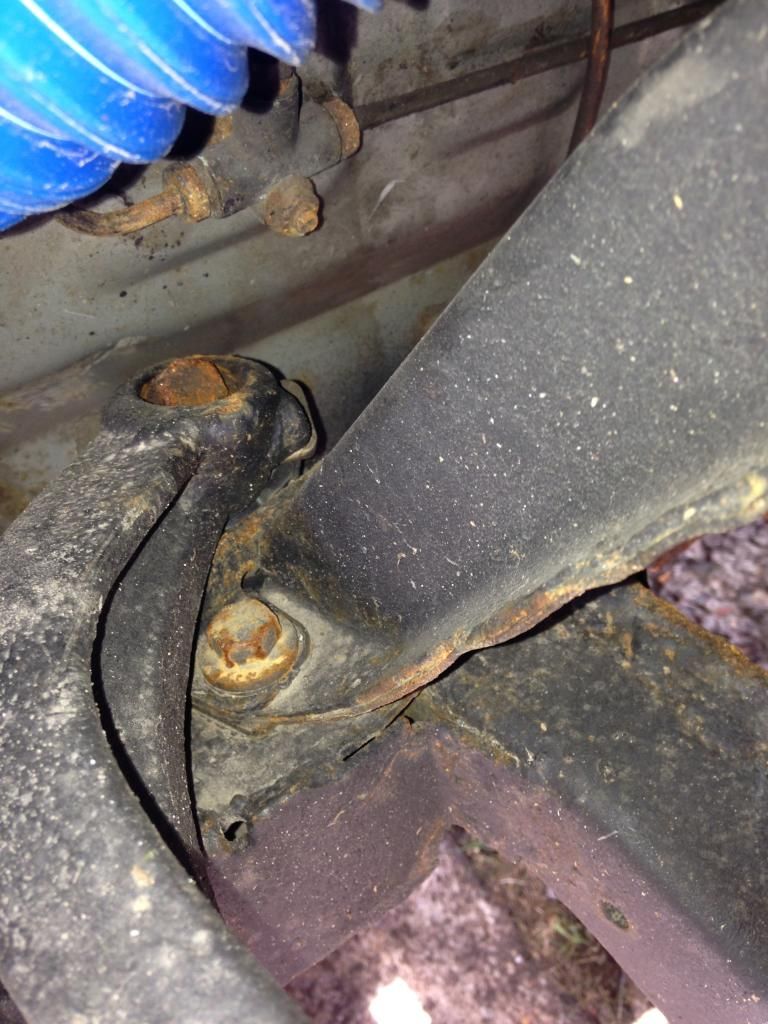

The other 2 which are essentially holding the bush in place, may cause you problems...
The nearside bolt is the larger of the 2 and is easily accessible, so should come off with no real problems.
The second, which is difficult to see from under the wheel arch is smaller and if rusted (which it will be) will be difficult to remove. Again this is another reason to remove the engine cover, as there is clear access from above.
This nut proved to be the most difficult part of my job. It required constant heat whilst a second person (my dad) loosened it very, very slowly.
